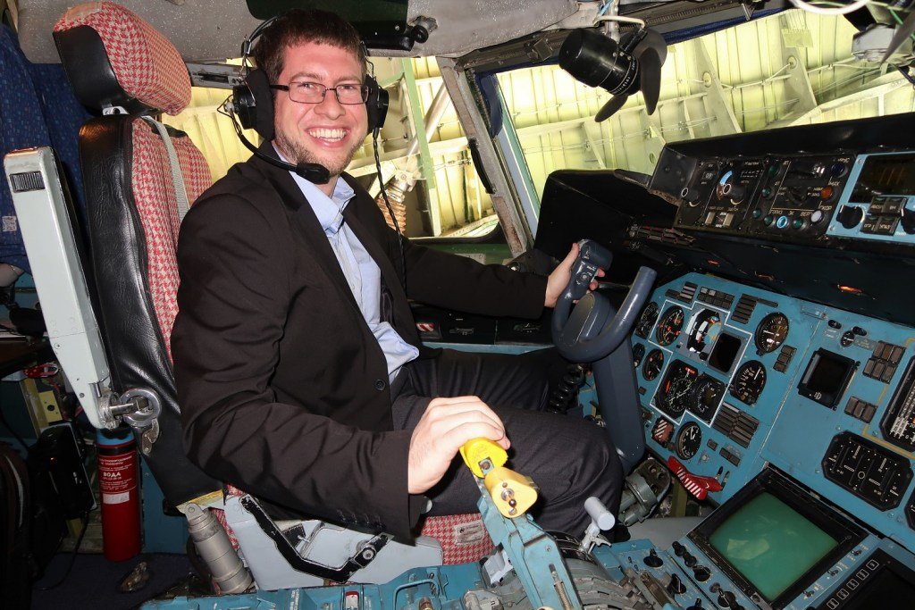

In the above image, we can see two black objects that look like ceiling fans. This is just a reference image, but I am pretty sure that I have also seen small table fans mounted in cockpits of large cargo as well as high altitude flying planes with direction facing pilots in one documentary aired on tv.
Are they fans? and what is the purpose of their direction towards front glass in the pressurized air-conditioned cockpit?

They are indeed "Soviet style air conditioning". You will see them in other Eastern-bloc aircraft too. We even had them in the Shorts Skyvan. They are operated by a simple on-off switch and can be swiveled to point in the direction chosen by the pilots. The fan blades are made of rubber so they won't cause injury if one's hand inadvertently comes into contact with them. In this picture of the Skyvan, you can see the fan (arrowed) and the switch (circled).
Here is another airplane with the ubiquitous Soviet Air Conditioning system, Tupolev 154.

    $\begingroup$ They are just fans @SwiftPushkar, there for pilot comfort. They swivel so pilots can adjust them, there's nothing more to it than that. $\endgroup$

  • $\begingroup$ @SwiftPushkar: the pilot aims the fan so he or she has a nice cool breeze blowing on them. Yes, it sounds a bit odd - in an airplane flying at a few hundred km/hr the pilot wants a nice cool breeze. ??? But there you are... :-) $\endgroup$ Oct 13, 2020 at 20:05
    $\begingroup$ And when aimed at the glass, the air flow will help defog the window. $\endgroup$

They ARE fans, and they're just for pilot comfort.
