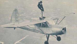

Wingwalking is an aerobatic discipline with shows such as this one. The definition of wingwalking from Wikipedia gives no other alternative than using biplanes:
Wing walking is the act of moving along the wings of a biplane during flight [...]
(source: Wikipedia, as of 26 February 2020)
When searching for images on the web, I can only find biplanes, mainly stearman but also other biplanes.
For me, it seems that any aircraft with high wings or parasol wings can do the job, so why do they only use biplanes?

It doesn't only use biplanes, searching "wingwalking monoplane" provides these examples, of some low wing monoplane and high wing monoplane. Whatever the aircraft, it has to be able to fly slowly.
enter image description here (source) (not 100% about this one but it looks like one Klemm aircraft)
enter image description here (source) (Here one quite rare danish SAI KZ III equipped with a hatch behind the wing, allowing acrobat Palle Johnson to get out.)

  1. The really obvious one; biplanes had the interplane structural network to hang on to when doing the wing walking. It's a heck of a lot safer for the wing walker. Even today, most of the wing walker acts use Stearman or Waco biplanes.
  2. They generally have lower wing loadings than comparable monoplanes so could fly slower.
  3. They were readily available as WWI surplus in the 20s when the whole Air Circus business was getting underway. Equivalent monoplanes would be new production and much more expensive to acquire.
So while there are/were monoplane wing walker acts, they weren't true "wing walkers". The original wing walkers walked out from the fuselage to the wing tip, and the usual trick on the Jenny was to get down and hang from the wing tip protector hoop that extends down below the interplane struts. It was only possible on a biplane because there was structure and wires to hang on to.
The monoplane acts are great stunt acts, but they aren't true wing walking acts because no, you know, walking along the wing, goes on. They have a brace to let someone stand up above the fuselage, but you won't see any of them walking out along the wing to the tip without any kind of aids, as you do on a biplane.
