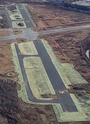

    $\begingroup$ After all that, be sure to look at a source like Airnav.com as runway numberings are only renamed/repainted very occasionally. An airport near me, KFIT, is currently under construction to change the runway heading by some number of degrees, and I think I informally heard to lengthen it. One can see the a picture of the change here chapters.eaa.org/-/media/Chapters/Chapter-Folders/EAA1454/… Apparently the shorter crossing runway is closed permanently too. $\endgroup$
