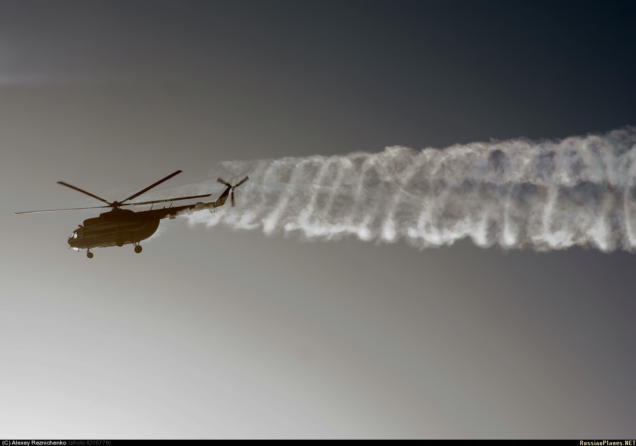

If the temperature and conditions are right, yes.
Any aircraft which has a heat engine that burns hydrocarbon fuel, which is pretty much any reciprocating or gas turbine engine used in aviation, will emit carbon dioxide and water vapor as byproducts of combustion. It’s just a byproduct of the chemical reaction to produce heat energy in the engine. And when the temperatures and humidity in the ambient air are low enough and high enough respectively, the water vapor in the exhaust stream will freeze into ice crystals that remain suspended in the atmosphere for a sustained period of time.
You typically won’t see this at your average airport or from the average helicopter flying over you as the temperatures simply are not low enough at the altitude the aircraft operates at for contrails to properly form. That being said, see picture below.
Image source: https://koreaaero.tistory.com/40 (in Korean)
4$\begingroup$ Carlo, that picture appears to be vortices trailing from the rotor tips. (and the aircraft is flying above translational lift) $\endgroup$ – KorvinStarmast Mar 4 '20 at 14:10
20$\begingroup$ @KorvinStarmast I'm not sure how you can state that conclusively. Contrails don't visibly connect directly to the engines (for example: upload.wikimedia.org/wikipedia/commons/4/47/…) and the movement of the rotors may mean they don't point directly back to the engines as a result. $\endgroup$ – ceejayoz Mar 4 '20 at 14:12
32$\begingroup$ Wooooow low altitude rotating chemtrail dispenser ! Sweet ! $\endgroup$ – Quentin H Mar 4 '20 at 16:07
4$\begingroup$ I very much doubt that those 'contrails' have anything to do with engine exhaust. As I asserted in my answer, the engine exhaust is hugely diluted and dispersed by the downwash and cannot possible leave a trail. The trails seen above are almost certainly from atmospheric moisture. $\endgroup$ – Fiddlesticks Mar 4 '20 at 17:25
4$\begingroup$ @Fiddlesticks Contrails from fixed wing aircraft are ‘hugely diluted by wingtip vortices as well. A helo will produce vortices, rotor wash or no, if the conditions are right. $\endgroup$ – Carlo Felicione Mar 4 '20 at 17:59
Contrails off the engine exhausts is unlikely. But in the right conditions, ie damp air, you can get contrails off the "wingtip" vortices, ie off the rotor blade tips.

In a word: NO.
All existing helicopters have their engine exhausts somewhere beneath the main rotor, and that means that the exhaust gases are hugely diluted and dispersed by the enormous downwash from the main rotor. It simply is not possible for a contrail to form under such dilution and turbulence.
17$\begingroup$ And yet: metabunk.org/data/MetaMirrorCache/… and bloximages.newyork1.vip.townnews.com/newsminer.com/content/… (found at reddit.com/r/hoggit/comments/2rty2j/…) $\endgroup$ – ceejayoz Mar 4 '20 at 1:06
2$\begingroup$ @KorvinStarmast Note in the first photo what appears to be denser condensation at the bottom of the trail, in line of the engines. The first photo also debunks the idea that the rotor downwash wipes out any visible condensation put forward in this answer. $\endgroup$ – ceejayoz Mar 4 '20 at 14:07
4$\begingroup$ I think that this answer would be better if the first line is: "generally, no" But that's my opinion. $\endgroup$ – KorvinStarmast Mar 4 '20 at 14:15
