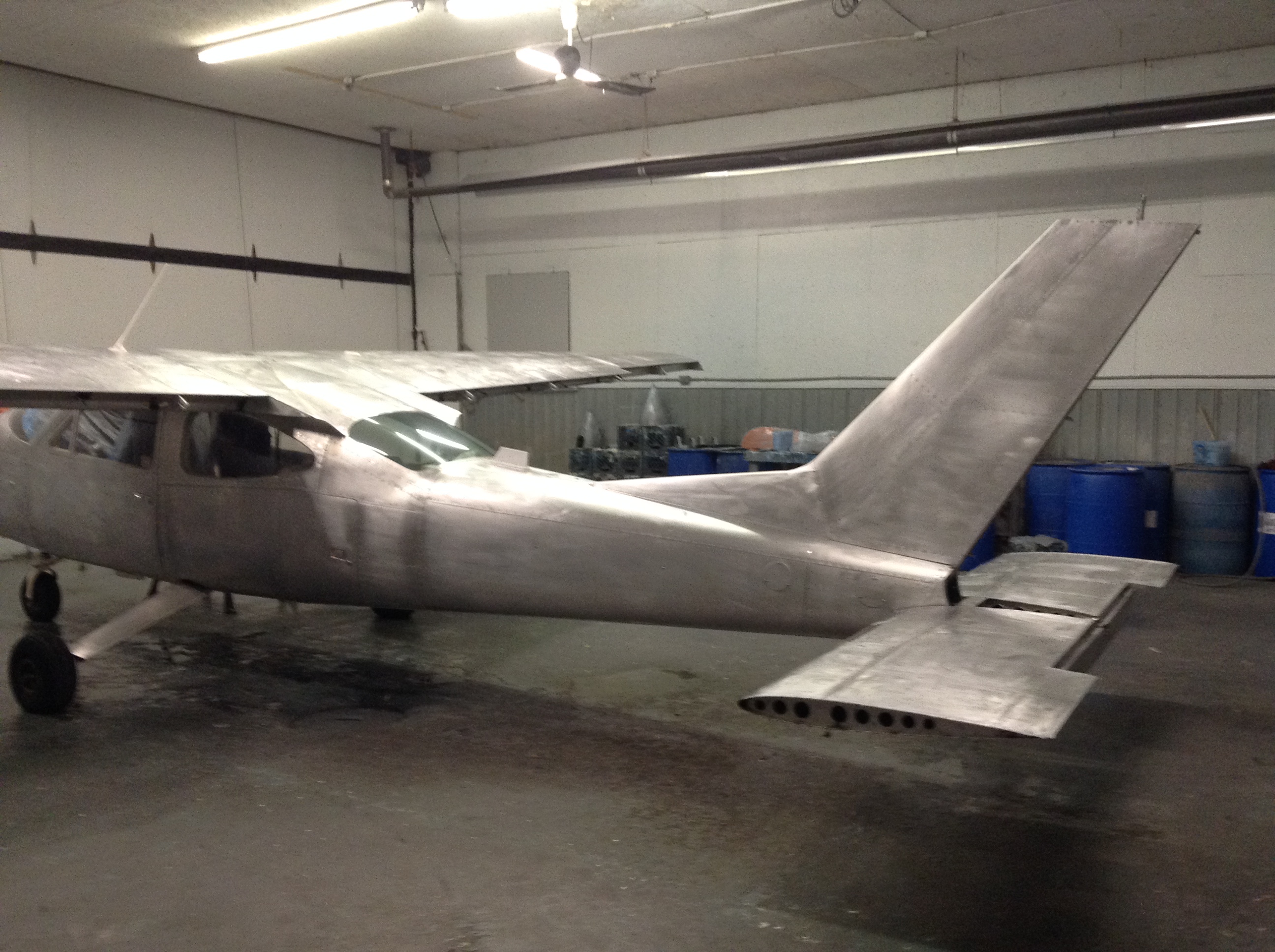

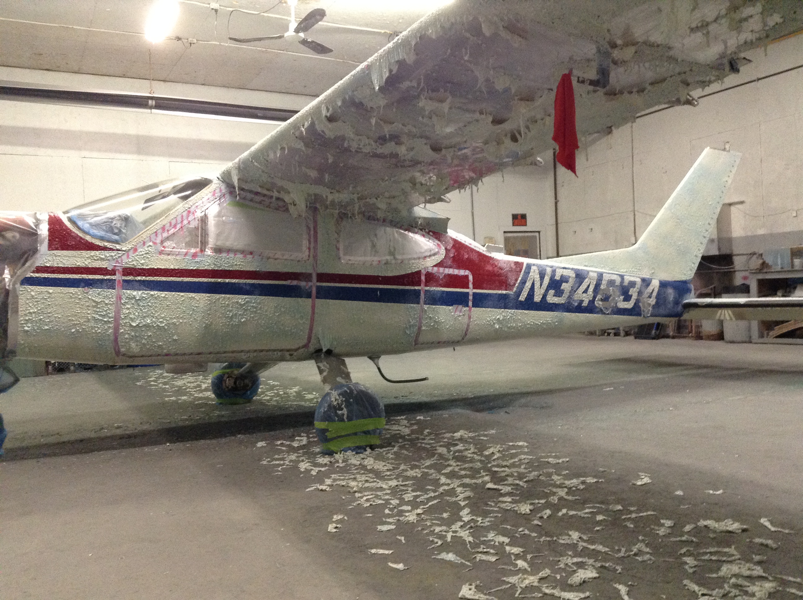

    $\begingroup$ When my plane was repainted in fall in 2018, paint stripper was used. Hydrogen peroxide based, it took everything off. crossroadsfencing.com/airplane/painting%20pics/IMG_0200.JPG After sitting overnight, the plane is rinsed and the wastewater collected in barrels to be shipped off and processed somehow. Some areas needed a 2nd application to get down to bare aluminum crossroadsfencing.com/airplane/painting%20pics/IMG_0202.JPG $\endgroup$

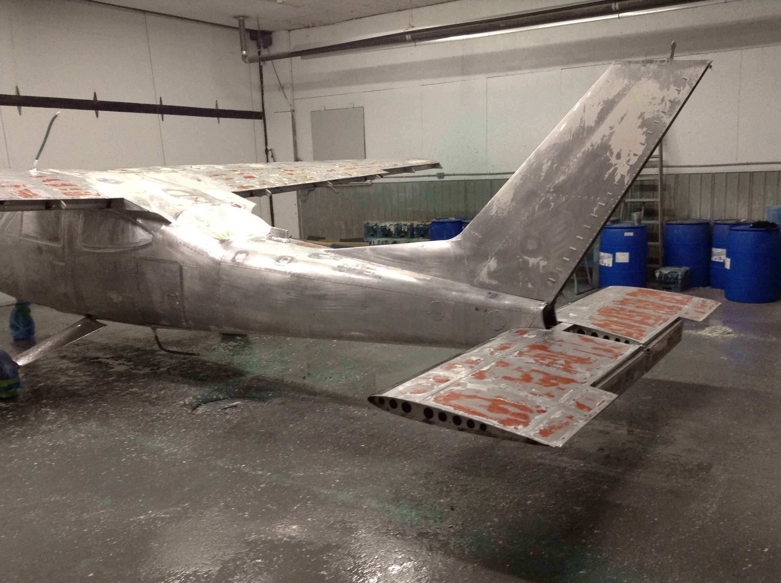

    $\begingroup$ Stripped planes are taken down to bare aluminim. The AL is then washed, acid etched (something like a mild vinegar), alodyne applied, then primer (the green color), then paint. The stripper doesn't know to stop at the primer level. This was mine after the alodyne stage, before primer crossroadsfencing.com/airplane/painting%20pics/IMG_0311.JPG $\endgroup$
