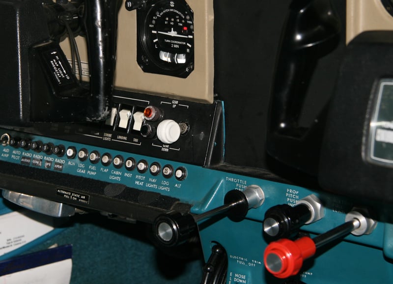

  • $\begingroup$ FAR §91.205 requires "Landing gear position indicator, if the aircraft has a retractable landing gear." On GA aircraft, that is either one or three lights. On mine, it is green for down and orange-yellow for up. $\endgroup$
    – JScarry
    Jul 26, 2017 at 13:32
  • $\begingroup$ @JScarry the position of the landing gear lever is a pretty good indicator too :) $\endgroup$
    – jwenting
    Aug 21, 2017 at 5:50
  • $\begingroup$ @jwenting If you have a Johnson bar gear lever, you can tell the position. Not so easy on my Cessna. touringmachine.com/images/Gear_Handle_Cessna210.jpg $\endgroup$
    – JScarry
    Aug 21, 2017 at 15:22
