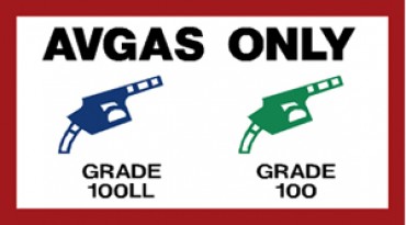

In contrast to the actual fuel limitations, the placard placed at the fuel port for the King Air B200 lists very little of the actual limitations:
fuel placard Source: Beechcraft King Air 200 Maintenance Manual

You know what fuel to put in your (light) aircraft, the same way as you know what fuel to put in your car - you've done it before and you know to lift the right nozzle at the bowser! For larger aircraft/airliners, chances are there is a person whose job it is to refuel your aircraft, and they will likely know very well what fuel to use. If they don't they would ask, or look up the correct fuel from somebody who does know.
There are a few things to help you remember, such as placards next to the fuel cap
The pipework/shut off at the bowser might also have a placards/indications/color-coding.
A for emergency fuel, that is part of flight planning - you calculate how much fuel you expect to use and add an amount on for emergency/contingency.

    $\begingroup$ In the US (and I think other parts of the world as well) there is mostly one type of aviation fuel available for piston engines—100LL. Some engines run on regular auto gas if it does not have ethanol added. My Cherokee had an auto gas STC before I upgraded the engine, but I never say it at any airport and don’t know if it is even available in California. My sticker looks like this chiefaircraft.com/id-low.html. On the Cessna, we don’t have a sticker, just text saying "Use 100LL only". $\endgroup$ – JScarry Jul 11 '17 at 17:57
