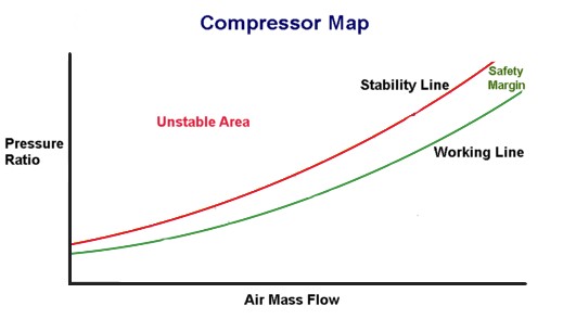

Regardless of the case, if the flow departs from the operating area at some location in the engine compressor, an aerodynamic stall of the compressor can be experienced exactly like a wing can stall:

A turbine engine works by reaching a precise equilibrium around the flow of air in the compressor, the combustion chambers and the turbine:
  • The turbine must receive a given quantity of energy to drive the compressor at the proper speed.
  • Combustors must receive the exact quantity of fuel and air to deliver the energy to the turbine.
  • Compressor must provide the required quantity of air to the combustors.
(Let's ignore the fact that turbine engines have most of the time two or three spools, i.e. compressor-turbine assembly with a mechanical linkage, each one turning at its own speed, which have to find this shared equilibrium).
As soon as air velocity or pressure changes for any cause, a new equilibrium must be found, else bad things start to happen. In a compressor stall, sometimes no new equilibrium can be reached. This lead to dramatic consequences.
