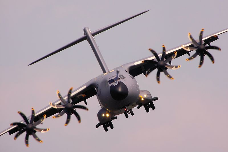

A parameter to catch blade count and chord relative to blade length, is the disk solidity $\sigma$. Area of all blades summed together, divided by the area of the circle defined by the blade tip length:
$$\sigma = \frac{\text{blade area}}{\text{disk area}} = \frac{A_b}{A} = \frac{N_b c R}{\pi R^2} = \frac{N_b c}{\pi R}$$ with $N_b$ = number of blades, c = blade chord, R = blade radius.
enter image description hereImage source
There does not seem to be a defined transition point of $\sigma$, above which we're talking about a fan. The 8-bladed propeller of the A400M with a blade radius of 2.6m has a solidity ration of about 0.3 which is amongst the highest in the world. We instantly recognise it as being a propeller.
from the Wiki pageAuthor 1
The fan of a geared turbofan like the PW 1000G is instantly recognisable as a fan, with its 20 relatively fat blades and a $\sigma$ close to 1. Note that both are driven by a gearbox for obtaining a beneficial tip speed.
Or are all turbofans technically shrouded propellers with some augmented thrust from the turbine exhaust ?
Indeed, technically a fan is a type of propeller. Turboprops also have thrust directly from the turbine exhaust.
1 By Rafael Luiz Canossa - IMG_9975, CC BY-SA 2.0, https://commons.wikimedia.org/w/index.php?curid=55662586
