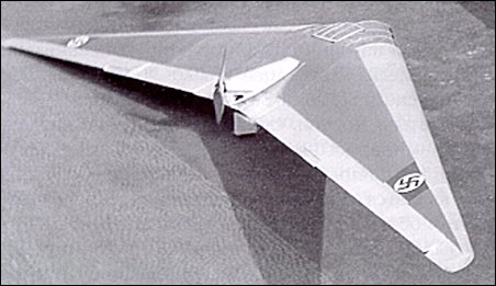

What you describe implies the use of artificially enhanced stability. There have been projects which did away with a vertical surface completely, lately to improve the low-observable characteristics. However, in each case you replace something that automatically produces a stabilizing effect with something that needs to be positioned actively in order to have a stabilizing effect. So far, the preference for safety has meant that active stability augmentation has not made inroads into regular aircraft - the added failure mode is simply not worth the gain in aerodynamic qualities.
An early example would be the Horten II motor glider (picture source)
A more recent example is the unmanned X-36 (picture source)
In both cases the designers simply left the vertical tail off and used other means for directional stability. Your proposed moveable tail surface has never been tried, as far as I know.
  • $\begingroup$ Is that a propeller at the rear center of the Horten? $\endgroup$
    – TomMcW
    Jul 27, 2016 at 23:46
  • $\begingroup$ @TomMcW: Yes, a fixed-pitch wooden propeller. The engine was a Hirth HM-60 with 60 hp. The Horten VII even had two propellers and two Argus As-10 C engine with 240 hp each. $\endgroup$ Jul 28, 2016 at 9:52
