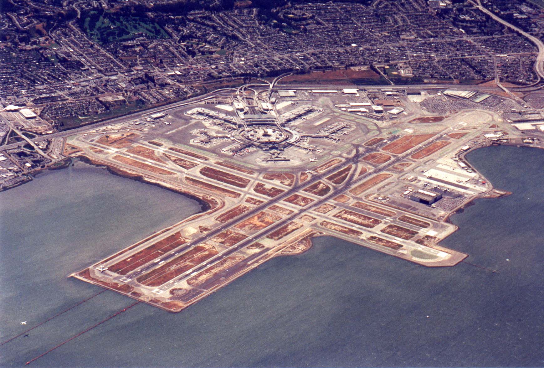

    $\begingroup$ If SFO is any indication, it can be awful close: richp.com/pics/aerial-05-20-01/sfo1.jpg $\endgroup$

Runway 28L and 28R at KSFO, as well as 19L and 19R, have their thresholds right next to the San Francisco Bay.
If you recall, in July 2013, Asiana Airlines Flight 214 landed short due to pilot error.
In November 1968, Japan Airlines Flight 2 completely missed the runway and landed in San Francisco Bay.
