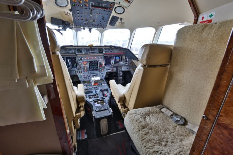

When operating a large turbine aircraft under 14 CFR 135, does the FAA allow a passenger to occupy the jump seat in the cockpit?
Falcon 900 jump seat
Would it matter whether or not they are a company employee (i.e. other than a flight crew member)?
Unlike the airlines, we usually fly with the cockpit door open (if there is even one installed) so it isn't a security issue like the airlines.
    $\begingroup$ I'm wondering if an FAA inspector would deem the seat in the image to be a proper jump seat. I suspect some would say that a jumpseat should be facing forward to allow the inspector to view the instrument panel without having to turn their head. Just a thought. $\endgroup$
    – Terry
    Mar 2, 2014 at 22:32
  • $\begingroup$ A friend of mine who flies 737 once told me: "as long as you are a trusted individual by the whole cockpit, you can sit there". But that is just a quote and I don't think it will convince the FAA when something happens :) $\endgroup$
    – Jelmer
    Mar 11, 2014 at 13:57
  • $\begingroup$ @Jelmer Well, in an airplane like this there isn't even a door to the cockpit so it it's less of a security concern than in an airliner where access is limited. $\endgroup$
    – Lnafziger
    Mar 11, 2014 at 14:18

Detailed answer but only applicable to aircraft with a door separating the cockpit from the cabin. The aircraft in the photo, a Falcon 900 series, as is true with all Falcon 2000 and 900 series aircraft, is placarded as a part of the Certification of the aircraft, and all with jump-seats are placarded with a restriction that the seat can be occupied for takeoff and landing by crewmembers only. As each passenger must have an approved seat for takeoff and landing, this would preclude the assignment of the jumpseat for passengers. In other words, if the aircraft is equipped with 10 passenger seats and the question is "can we use the jumpseat as a seat for the eleventh passenger, the answer would be no.
