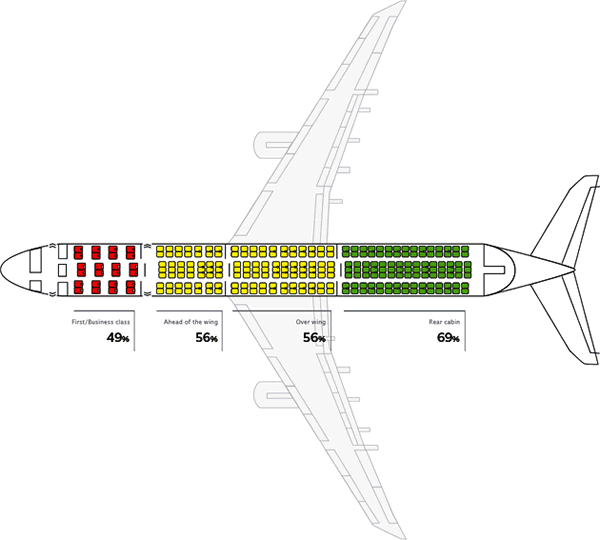

When an aircraft is crashed, the entire front of the aircraft is expected to act as a crush zone. By placing FDRs and CVRs near the tail, the shock wave that reaches FDRs and CVRs is reduced significantly.
The probability of survival based on seating is shown in this picture:
Hence one can see that the shock wave reduces as it reaches the rear of the plane. That is the reason FDRs and CVRs are installed in aircraft's empennage section.
Please note that the precise location of the recorders depends on the individual plane. Sometimes they are located in the ceiling of the galley, in the aft cargo hold or in the tail cone that covers the rear of the aircraft.
15$\begingroup$ And Business Class passengers actually pay for the privilege of travelling inside the crush zone. $\endgroup$ Jan 13, 2015 at 1:40
4$\begingroup$ @PieterGeerkens Shhhh! Don't tell them that. $\endgroup$– Farhan ♦Jan 13, 2015 at 1:41
12$\begingroup$ @PieterGeerkens and this is actually a great incentive for pilots to not crash. $\endgroup$– SandyJan 13, 2015 at 1:48
4$\begingroup$ @MarchHo depends on how those percentages are sold/read: in the current state they mean "if there are survivors at all, this is where is likely to find them", but most people expect a chart saying "if there is a crash, this are your chances of survival", something you obtain including crashes with no survivors. $\endgroup$– Federico ♦Jan 13, 2015 at 8:08
4$\begingroup$ @Federico And it's very important to include the crashes where everybody died. The difference of 69% at the back versus 49% at the front looks huge but it might be an artifact of the data selection. As you add more and more crashes with 100% fatalities to the data, those numbers will get closer and closer together (and closer to zero). $\endgroup$ Jan 13, 2015 at 10:29
