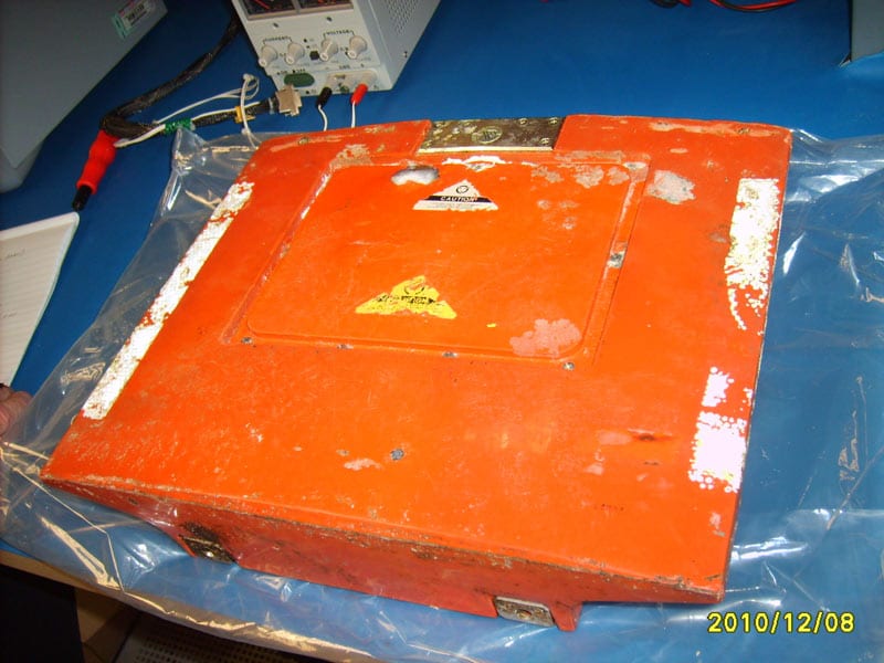

Time has an article showing the Air France 447 flight data recorders resting on the bottom of the ocean (there are others there):
FDR image 1 FDR image 2
This particular FDR is pretty common, and weighs about 13.5 pounds1.
